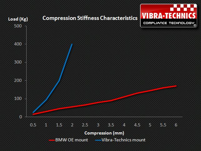

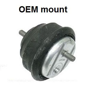

I found the standard mounts (even when new) allowed to much movement during hard acceleration/braking. I fitted Vibratechnics road mounts (360M were c.£130 each, which is cheaper than the price for OE parts from BMW; US site shows $325/pair) and it removed the excessive squatting & diving completely.
This was about a year before I went further and fitted Bilstein B16 PSS10 suspension for better/less choppy road manners.
OEM
Vibra-Technics
Stiffness comparison
They're rebuildable too, but I've had mine on for over 60,000 road & track miles and they still look great.
https://www.vibra-technics.com/bmw/z...t_engine_mount
