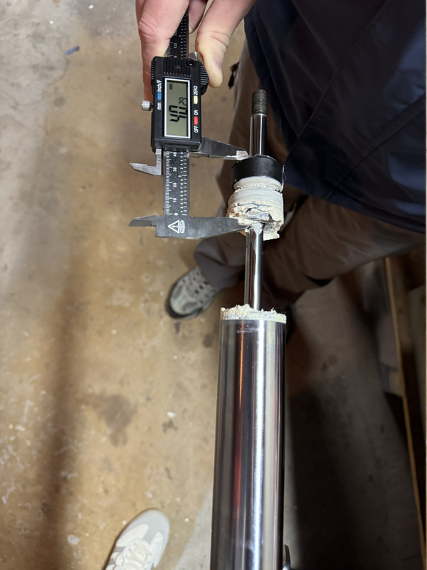

Originally Posted by maupineda View Post
The front B6 dampers have too long of a bump stop (70mm), the stock is about 44mm. so what I did is that i trimmed it to 40mm. this would retain the suspension travel same as stock, otherwise you would be riding on the bump stop much. That is why some people complain about a bumpy ride. the Bump stop is internal, so you need to open up, take it out, and cut.
Just fyi, I opened a new B6 for Z4M and the bump stop length was about 40-42mm

They may have changed it. Good to hear. Mine were 60mm. Will post a pic.
Pic attached. It’s compressed very slightly by the calipers and was full of grease but it’s about 41.
