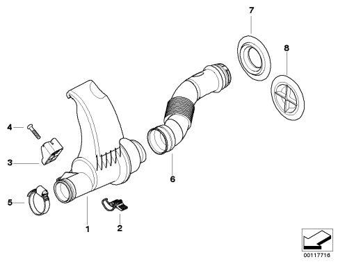

all z4's with the N52 had the sound generator. here is the 3.0i version...
it is very easy, less than 5 min. when you pull item (6) from the firewall, you'll see the 2nd foam piece hiding inside it. item (8) does not apply. reinstall (7) into the firewall before pressing (6) back in. the other side is just hose clamps.
Not correct all SI's with the n52 came with the sound generator, the 06 to 08 3.0i did not come with them as I had to retrofit it into my car.

Here is a link and a pic.. Sound generator assembly is circled.....
http://www.realoem.com/bmw/showparts...73&hg=13&fg=20
